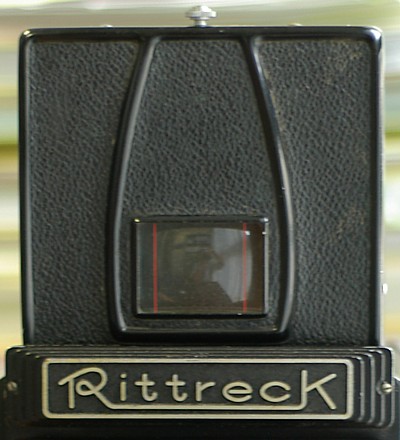

Rittreck
Optika IIa with Luminant 105mm f/3.5
There was no auto-return mirror, so the shutter had to be cocked after each exposure to restore the image on the ground glass. This camera was equipped with a vertical cloth focal plane shutter offering speeds from 1/20s to 1/400s + B. The later Rittreck SP model added slow speeds from 1/2s to 1/10s.

The Rittreck's huge waist level reflex finder offered a large ground glass with a Fresnel lens for added brightness and a folding magnifier. Markings were etched on the ground glass for accurate framing with the 4 formats supported by the camera. There was also a built-in eye level Galilean finder. To use it, the front panel of the focusing hood had to be folded in.
